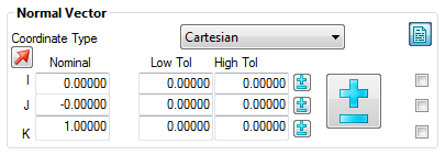

The Coordinate nominal area enables you to specify nominals for the item's Normal vector. PowerInspect can then report the difference between the nominal values and the measured values. Use the following settings:
Coordinate type — Choose an entry in the list to specify the nominal format. Select:
to display the
Define Entity Boundaries dialog.
Nominals — Type the nominals of the feature in the Nominal boxes.
For example, for the Normal vector, the nominal is entered in IJK values:

Tolerance range — Click the
buttons if you want to
set a tolerance range for the item.
Output in report — Use the check boxes to the right of each nominal value to control whether its details are shown in the report and CAD view labels. In the example above, none of the IJK values are included in the report or labels.
