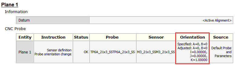

Application default — Select this check box to automatically adjust the probe head angles in all new documents. Deselect this check box to create documents that use the probe head angles specified by the user.
Current document — Select this check box to automatically adjust the probe head angles in the current document. Deselect this check box to run the inspection sequence using the angles specified by the user.
When automatic adjustment is enabled for a document, the original and adjusted angles are displayed in the Orientation column of the Info tab.
