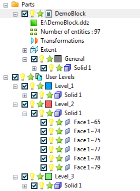

To display information about a CAD model, and its levels and objects, click
next to
Parts
and
User Levels
. For example:
