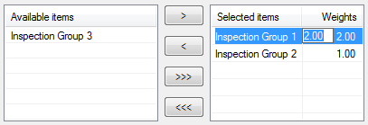

to move the selected group from the Selected items list to the Available items list.
to move the selected group from the Available items list to the Selected items list.
to move all groups in the Available items list to the Selected items list.
to move all groups in the Selected items list to the Available items list.
By default, each group in the Selected items list has an equal effect on the fit. To assign greater emphasis to a group's measurements, click the group, click the weight value, and then type a multiplier in the entry box.
For example, if you enter a weight of 2.00 for Inspection Group 1, the effect is the same as entering each point into the calculation twice. This doubles the effect of the group on the residual error:
