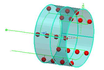

When you create an item using the Wireframe Checker, PowerInspect takes the direction vector of the item from the CAD model. The vector is shown as a solid yellow line with an arrow in the CAD view. For example:
To reverse the direction vector and the item's probe path:
button. The button icon changes to the Reversed
icon and the change is displayed in the CAD view. For example:
button to save your change.
