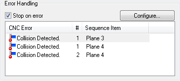

The Error handling list contains the errors identified by PowerInspect. Each entry specifies the type of error, the number of errors in the move, and the sequence item in which the error occurred. For example:
The type of error is also indicated by the icons at the left of each entry:
The probe collided with the part.
The probe started within the space occupied by the part.
The probe moved outside the machine limits.
The probe made an illegal contact.
An expected contact was missed.
