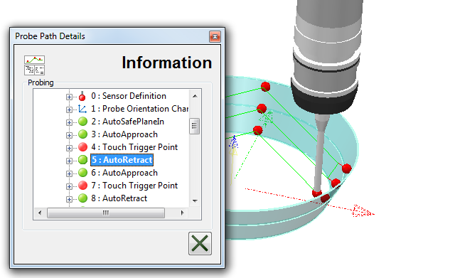

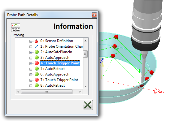

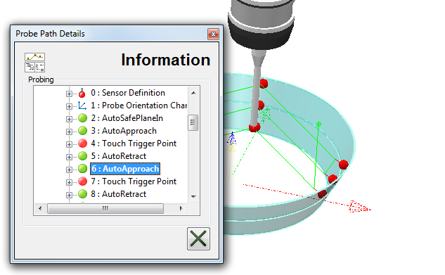

The Information dialog enables you to view the details of the probe path, and to step through the path one move at a time.
To step through each move in the probe path:

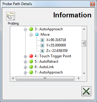

button. The Probe Path Details dialog is displayed.If you want to view more details about a move, click
. For example:
