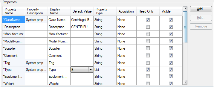

  1. In the Project Setup tree view, expand P&ID Class Definitions.
  2. Continue to expand the list until you locate and click a component (for example: Centrifugal Blower).
  3. On the Class Settings pane, under Properties, click Add.

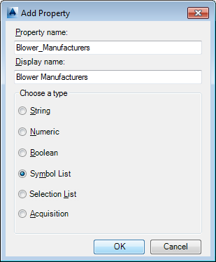

  4. In the Add Property dialog box, do the following;
    • Click Symbol List.
    • Specify a property name for the component or line (for example: Blower_Manufacturers).
    • Specify a display name for the component or line (for example: Blower Manufacturers).
    • Click OK.
