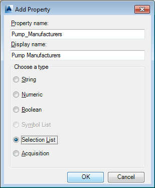

  4. In the Add Property dialog box, do the following;
    • Under Type, click Selection List.
    • Under Property Name, enter a name for the new property (for example: Pump_Manufacturers). The name cannot contain any spaces.
    • Under Display Name, enter the name you want to be displayed for the new property (for example: Pump Manufacturers) in the Data Manager or Properties palette.
  5. Click OK.

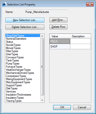

  6. In the Selection List Property dialog box, click New Selection List.
  7. In the Add Selection List dialog box, enter the name for the new selection list (for example: Manufacturers). Click OK.
  8. In the Selection List Property dialog box, click Add Row.
  9. In the Add Row dialog box, enter the new value (for example: Goulds) and a description of the value, if necessary.
  10. Continue adding rows until the selection list is complete.
  11. Click OK.
