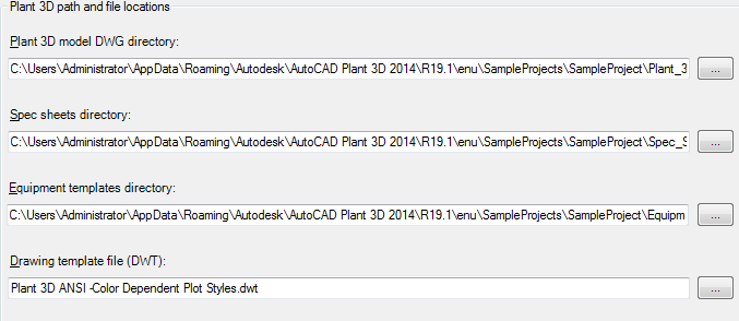

- In the Setup tree view, expand Plant 3D DWG Settings. Click Paths.
- On the Paths pane, do one of the following:
- Enter the file paths for the directories you want to change.
- Click the [...] button to the right of each box to browse to the location where you want to store the directory and file.
- Click OK.

- In the Project Setup dialog box tree view, expand 3D Piping DWG Settings. Click Paths.
- On the Paths pane, under Orthographic template file (DWT), enter the path to the location of your template file or click the [...] button to browse to the location. The default folder depends on the operating system:
- On the Paths pane, under Spec Sheets Directory, enter the path to the location of your spec files or click the [...] button to browse to the location.
- Click OK to close the Project Setup dialog box.
