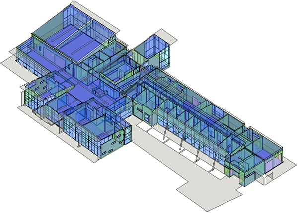

3D Energy Model View
When you click Create Energy Model, Revit creates the energy model and displays it in a 3D view named 3D Energy Model. The view is listed in the Project Browser under 3D Views.
The 3D Energy Model view uses settings in the Visibility/Graphics dialog to hide some categories of building elements and to apply 50% transparency to other model categories, such as floors and roofs. The view also displays analytical spaces and analytical surfaces laid over the building elements.
Use the view to understand how Revit interpreted the building elements to create the energy model. You can pan, zoom, and rotate the energy model to examine it closely.
To enhance your understanding of the energy model, create duplicate views of the 3D Energy Model view and adjust the Visibility/Graphics settings. In one duplicate view, for example, you may want to hide all model elements (clear the Visibility check boxes for all items listed on the Model Categories tab) and display only analytical spaces (listed on the Analytical Categories tab). In another duplicate view, you can hide model elements and display only analytical surfaces. (See Specify Element Category Visibility.) Examine these views to identify ways in which you can improve the building model to better support energy analysis or to troubleshoot the source of issues with the analysis results.
Tip: When you create a duplicate view with Visibility/Graphics settings that help you to understand and review the energy model, create a view template for those settings. Then you can easily apply the settings to views for future energy analyses. See View Templates.
