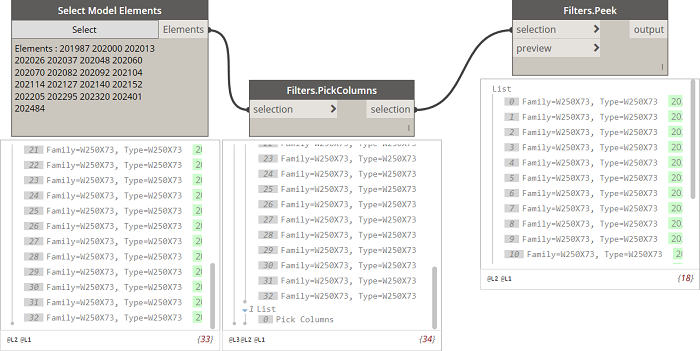

Filters.PickColumns Defines way of filtering objects from the selection: extract all columns from the selection |
| Library | Dynamo4AM → Utilities → FilterElements | |
| Input | selection | Any list of objects and filtering schedule, if defined |
| Output | selection | A list of objects and filtering schedule, including the line executing extraction of columns from the selection |
| Remarks |
This node does not filter elements but flattens the input list and adds a filtering label at its end. The filtering will be executed by translation nodes. Filtering may be also performed by the Filters.Peek node. |

Filters.Peek Filters objects basing on a defined filtering schedule |
| Library | Dynamo4AM → Definition → Filters | |
| Input | selection | Any set of objects and a filtering schedule, if defined |
| preview | Whether the filtered elements should be changed for lines and surfaces that are visualized in Dynamo preview | |
| Output | output | A list of elements that are extracted from the selection basing on the defined filtering schedule |
| Remarks | Filtering is also executed inside translation nodes. | |
