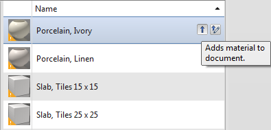

To add a material to the current project, first find the material in an existing library, then use one of these methods:
Add to
Document Materials.
located to the right of the material.
