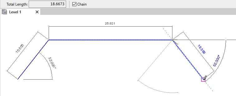

The Total Length box on the Options Bar keeps a running total for the length of the chain. Double-click to end the chain.
Measure line with length and angle measurements
Measure chain with the total length displaying on the Options Bar
