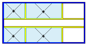

For example, the following floor plan shows rooms being placed using the room boundaries defined by walls in the host model (blue walls) and walls in the linked model (yellow walls).
