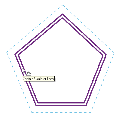

If you specified an offset distance using the Numerical option, a preview line displays at that distance from the highlighted elements on the side where the cursor is positioned, as shown.
Cursor at outside face of the wall
Cursor at inside face of the wall
