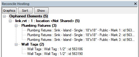

To review orphaned elements
- Click Manage tab
Manage Project panel drop-down
(Reconcile Hosting).
The Reconcile Hosting browser displays. By default, it is docked on the right side of the window. You can move it by dragging its title bar to the desired location. For more information on changing the size and position of the Reconcile Hosting browser, see
Dockable Windows.
- (Optional) To locate orphaned elements, do one of the following:
Change graphics
- In the Reconcile Hosting browser, click Graphics.
- In the Graphics dialog, select Apply settings to elements in the list.
- Specify values for Weight, Color, and Pattern.
The project displays orphaned elements using these settings.
Show an orphaned element
- In the Reconcile Hosting browser, select the orphaned element to locate.
- Click Show.
Revit LT displays the orphaned element, opening another view and zooming in, if needed.
- To delete an orphaned element that is no longer needed, select the element in the Reconcile Hosting browser, right-click, and click Delete.
- To rehost an orphaned element, select the element in the Reconcile Hosting browser, right-click, and click Pick Host. Then in the drawing area, select the new host.
