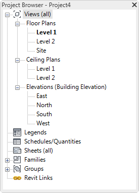

Project Browser
The Project Browser shows a logical hierarchy for all views, schedules, sheets, groups, and other parts of the current project. As you expand and collapse each branch, lower-level items display.
To open the Project Browser, click View tabWindows panelUser Interface drop-downProject Browser, or right-click anywhere in the application window and click BrowsersProject Browser.

The active view name displays in bold.
