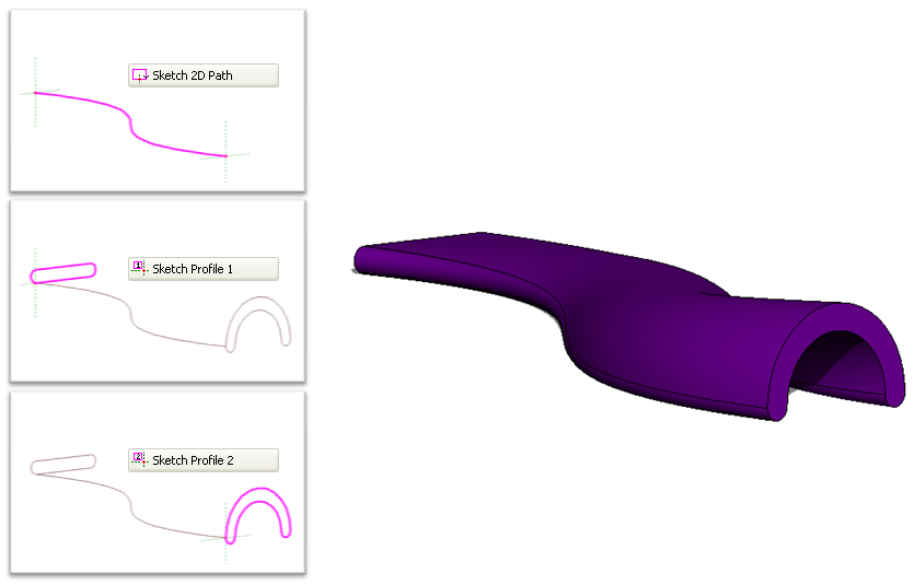

The Swept Blend tool allows you to create a blend that has 2 different profiles and then sweep it along a path. The shape of a swept blend is determined by the 2D path you either sketch or pick and the 2 profiles you either sketch or load.
The following procedure is a general method for creating a swept blend. Steps may vary depending on your design intent.

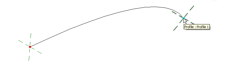

  2. Specify the path for the swept blend.
    Note: If necessary, set the work plane before you sketch or pick the path for the swept blend. Click Create tabWork Plane panel (Set).
    Do one of the following on the Modify | Swept Blend tabSwept Blend panel:
    • Click (Sketch Path) to sketch a path for the swept blend.
    • Click (Pick Path) to pick existing lines and edges for the swept blend.
  3. Sketch or pick the path.
    To select edges of other solid geometry, such as extrusions or blends, click Pick Path. Or pick existing sketch lines, watching the status bar to know what you are picking. This method of picking automatically locks the sketch lines to the geometry you are picking and allows you to sketch the path in multiple work planes, hence allowing for a 3D path.
    Note: A swept blend path can only have one segment.
  4. On the Mode panel, click (Finish Edit Mode)

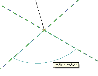

  5. Load or sketch Profile 1.
    The end point for Profile 1 on the swept blend path is highlighted.
    • To load a profile:
      1. Click Modify | Swept Blend tabSwept Blend panel, and select a profile from the Profile drop-down.
        If the profile you need is not already loaded in the project, click (Load Profile) to load the profile.
      2. Zoom in to see the profile.
      3. Use the X, Y, Angle, and Flip options to adjust the position of the profile.
        Enter values for X and Y to specify the offset for the profile.
        Enter a value for Angle to specify the angle of the profile. The angle rotates the profile around the profile origin. You can enter negative values to rotate in the opposite direction.
        Click Flip to flip the profile.
      4. Click Apply.
