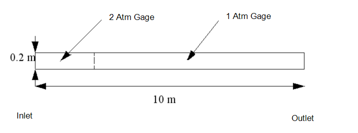

For this verification case a shock tube (10 meters long, 0.2 meters diameter) is modeled with an initial static pressure ratio of 3:2. The initial pressure condition simulates the dividing membrane in a real shock tube. Once the membrane is broken, the higher pressure expands into the low pressure air and a normal shock travels down the tube at a supersonic speed. The shock speed is determined by the initial condition pressure ratio across the membrane.
Geometry and Boundary Conditions
Initial Conditions:
Boundary Conditions:

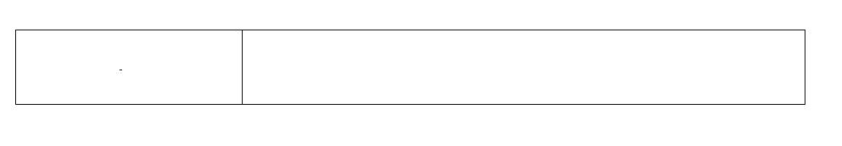

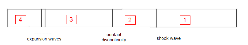

The following figures show the scenarios before the membrane is broken (top) and after it is broken (bottom).
| Ideal Flow (Benchmark) | 2018: Build 20170308 | % Error | 2019: Build 20180130 | % Error | |
| Shock Ma | 1.09 | 1.177 | 7.99 | 1.178 | 8.04 |
| P2 = P3 | 1.464 atm | 1.450 | 0.95 | 1.451 | 0.872 |
