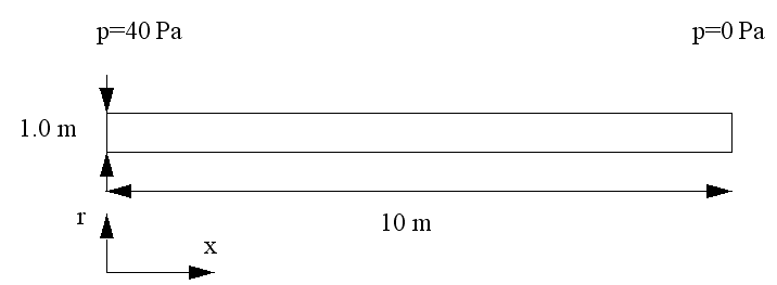

Problem Description
For this case, fluid in a long pipe is initially. A uniform, constant pressure gradient is instantaneously applied. Axial flow starts, and gradually approaches Poiseuille flow. The results are compared to an analytic solution from the reference.
Geometry and Boundary Conditions
Initial Condition: u(x,r,t=0)=v(x,r,t=0)=0.0,
= 4.0
Boundary Conditions: v(x,r=0,t>0)=0.0, u(x,r=1,t>0)=v(x,r=1,t>0)=0.0, p(x=0) = 40, p(x=L) = 0
