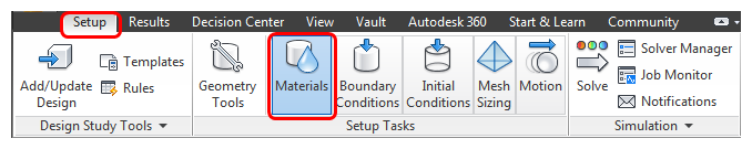

Click Materials from the Setup tab:

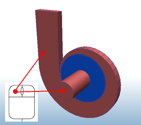

Select the volute and the inlet pipe

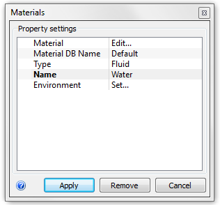

On the Material quick edit dialog, Type = Fluid
Name = Water
Click Apply.
