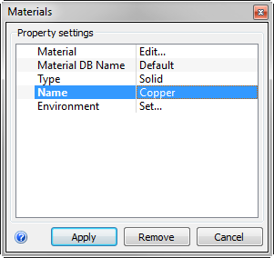

Open the Materials quick edit dialog in ONE of the following ways:
On the Material quick edit dialog, Type = Solid.
Name = Copper
Click Apply.
