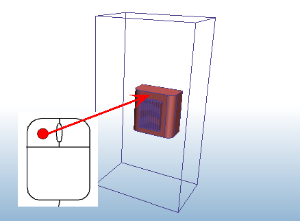

Assign Aluminum Material
To show all parts, hold the Ctrl button and click the middle mouse button in the graphics window (off of the model).
Hide the outer air part.
Select the Case part.
