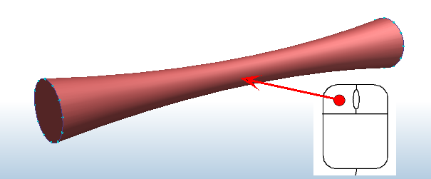

Select the nozzle.
To modify the mesh sizing, do ONE of the following:

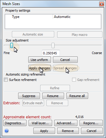

Move the Size Adjustment slider to 0.25.
Click Apply changes.
Click Spread Changes.
This ensures there is enough mesh to resolve the velocity and pressure flow gradients.
