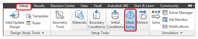

1. Switch to the Mesh task by clicking Mesh Sizing from the Setup tab:
2. Click Autosize on the Automatic Sizing context panel:
What it should look like...

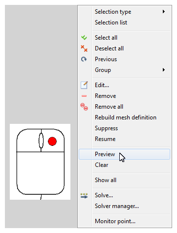

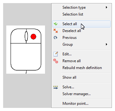

3. Right click off the model, and click Select all.
4. Right click off the model again, and click Preview.
Note: This process does not construct the complete 3D mesh, but it does create a view of the mesh on the surfaces. It should take about a minute...
The mesh on every surface of the model is displayed:

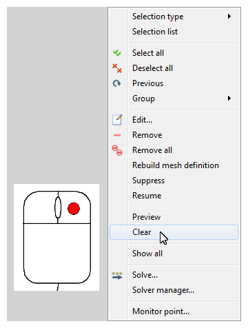

5. Rotate the model, hide parts, and zoom in to see how the mesh will look on the occupant.
When finished, right click off the model and click Select all. Right click again, and click Clear. This removes the preview display from the model.
