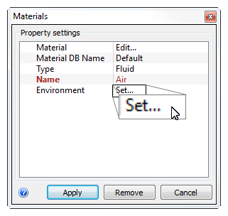

3. Click Edit from the Materials context panel:

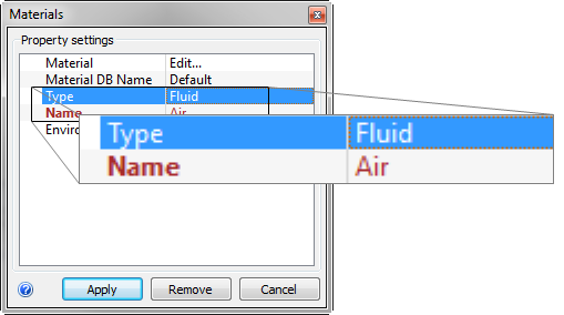

4. On the Materials quick edit dialog, verify the Type is Fluid, and the Name is Air.
5. In the Environment row, click Set...

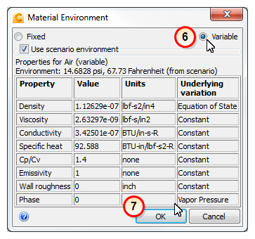

6. On the Material Environment dialog, click Variable
7. Click OK.
Note: In steps 6 and 7, we modified the definition of the Air material to allow the properties to vary with the temperature. This is necessary because buoyancy plays a pretty important role in the air movement within exhibition hall.

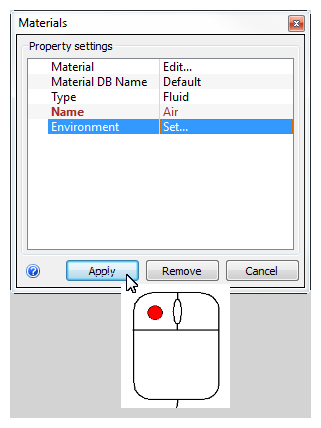

8. Click Apply on the Materials quick edit dialog.

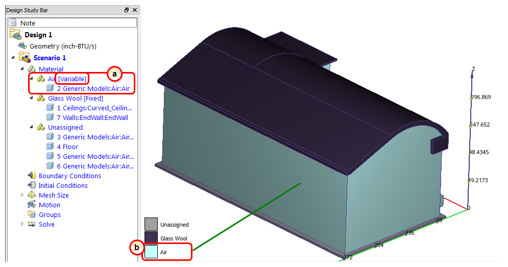

What it should look like...
9. To verify that the air material is properly assigned, check the Design Study Bar and the part coloring:
Note: If everything looks good, then continue to the next step. If there's a problem, now is a good time to fix it.
