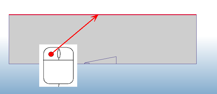

Assign Free-Stream Velocity Boundary Condition
Select the Top Edge

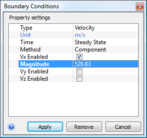

Open the Boundary Conditions quick edit dialog in ONE of the following ways:
Type = Velocity
Units = m/s
Method = Component
Check Vx Enabled
Vx = 520.83
Click Apply.
