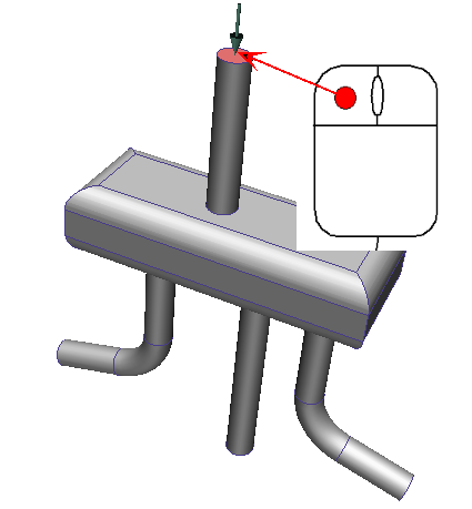

Click Boundary Conditions from the Setup tab:
Open the Boundary Conditions quick edit dialog in ONE of the following ways:
- Click Edit from the context toolbar:
- Click Edit from the boundary conditions context panel:

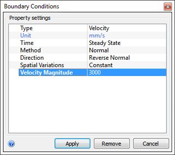

Type = Velocity
Units = mm/s
Velocity Magnitude = 3000
Click Apply.
