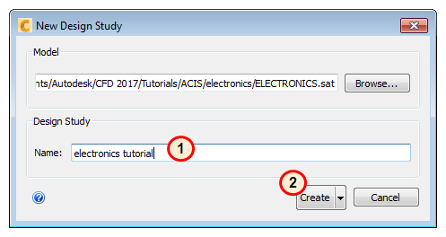

On the New Design Study dialog, click Browse.
On the File manager dialog, navigate to Users\Public\Public Documents\Autodesk\CFD 2019\Tutorials\<file type>\electronics.
Notes: <file type> is ACIS or Parasolid.
Click Open.
Step 3: Create the Design Study
  1. Enter a Name for the new design study. This can be anything you want.
  2. Make sure Create is the active option on the button, and click Create.
Autodesk® CFD starts, and creates the Design Study for the tutorial.
