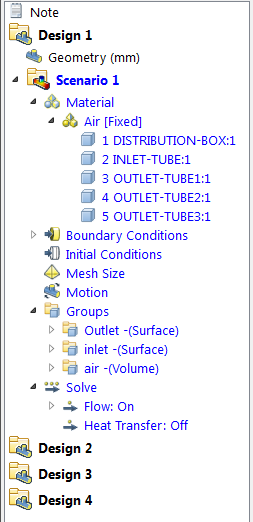

The design study has been created in Autodesk® CFD, and consists of four designs. Each design has a scenario that is fully defined with boundary conditions and materials:

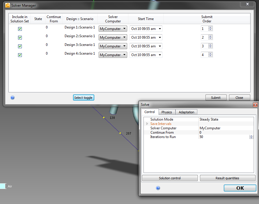

To open the Solver Manager, right click off the model, and select Solver manager...
Click the Select toggle button so that all will run when launched.
Note: By default, each scenario runs 100 iterations.
To reduce the number of iterations (for brevity), click on a scenario name, and modify the Solver dialog. Click OK.
Modifying the Sover Computer to Cloud if you would like to further reduce runtime by solving simultaneously in the cloud
Note: Cloud credits will be charged to your account, more information about cloud solving requirements can be found here.
Repeat for all scenarios, as appropriate.
Click Submit to start the analyses.
Note: The four scenarios will run in the order specified in the Submit Order column.

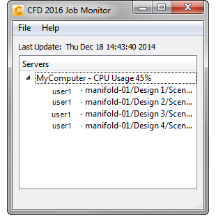

To view the status of each scenario, click Job Monitor from Setup (tab) > Simulation (panel):
For more about the Solution Monitor...
