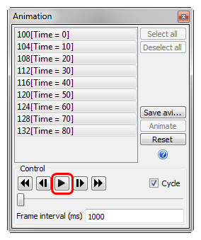

To open the Animation dialog, right click off the model, and select Animation.
Click the Select all button
Click the Animate button.
Click the Play button to animate the results.
To stop the animation, click the Pause button.
To clear the Active Results list, click the Reset button.
