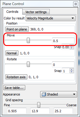

Right click on the plane, select Edit. Make sure the plane is at 0.5.

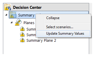

To start comparing results, click the Decision Center tab:
In the Decision Center, right click on Summary Values, and click Update summary values.

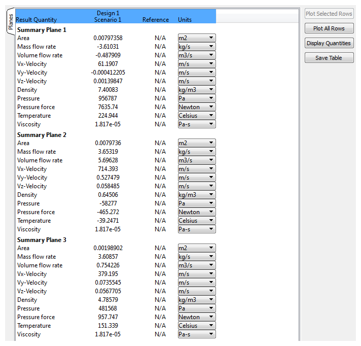

Note: View the Summary Plane data on the Planes tab of the Decision Center.
Note: The inlet is plane 1. The outlet is Plane 2. The throat is Plane 3.
