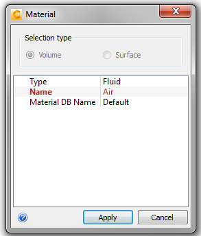

To create the air material:
Right click on Scenario 1. Select Add material...
On the Material quick edit dialog, Type = Fluid
Name = Air
Click Apply.

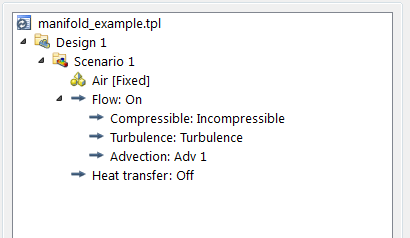

Note: The default solver settings are appropriate for this design study.
Note: The Template should look like this:
Click Save.
