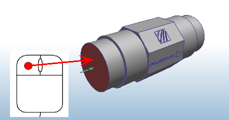

Select the inlet.

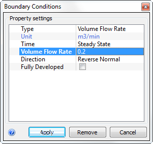

Open the Boundary Conditions quick edit dialog in ONE of the following ways:
Type = Volume Flow Rate
Unit = m3/min
Volume Flow Rate = 0.2
Click Apply.
