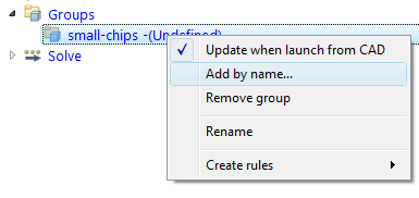

On the Design Study bar, right click on the small-chips group, and select Add by name.
In the Add by Name dialog, check the Regular Expression box. Type "S-CHIP". (This is case sensitive.)
Click OK.
Note: The small chips group on the feature tree should now contain all of the small chip parts:
