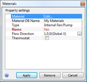

Assign the Internal Fan
Hide the case, air, and fan housing.
Select the fan.
Open the Materials quick edit dialog in ONE of the following ways:
Material DB Name = My Materials
Type = Internal Fan/Pump
Name = Fan
Click the X button on the Flow Direction dialog.
Note: The flow direction should be in the positive X direction (1, 0, 0).
Click Apply.
