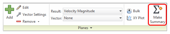

Left click on the plane, and click the Surface Align icon. Select the inlet surface.
To make the plane a Summary Plane, click Make Summary in the Planes context panel:

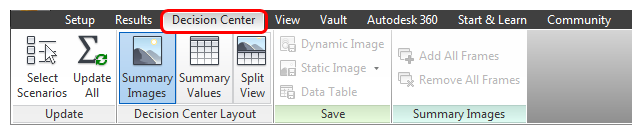

To start comparing results, click the Decision Center tab:

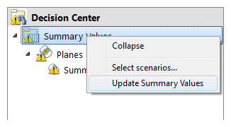

In the Decision Center, right click on Summary Values, and click Update summary values.

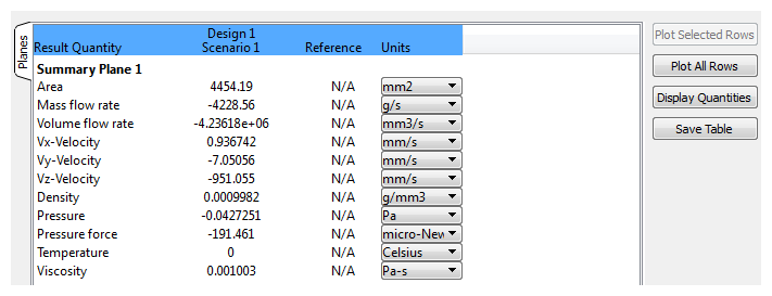

Note: View the Summary Plane data on the Planes tab of the Decision Center.
