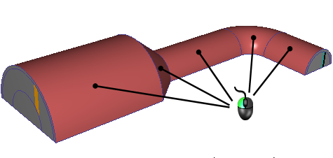

Assign the Film Coefficient Boundary Conditions
Select the 5 outer walls.
Open the Boundary Conditions quick edit dialog in ONE of the following ways:
