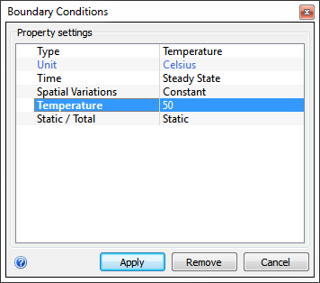

Assign Inlet Temperatures
Assign 50°C to the High Temperature Inlet:
Select the high temperature inlet
Open the Boundary Conditions quick edit dialog in ONE of the following ways:
Type = Temperature
Units = Celsius
Temperature = 50
Click Apply.
