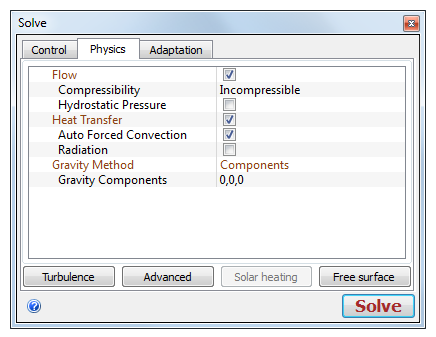

Click Solve from the Setup tab:
Click the Physics tab.
Flow = On
Heat Transfer = On
Auto Forced Convection = On
Click the Control tab.
Iterations to run = 100
Click Solve to start the analysis.
Note: Auto Forced Convection causes the analysis to automatically run in two stages. The first stage is flow-only (without heat transfer). The second stage solves for heat transfer only, and runs up to an additional 100 iterations.
