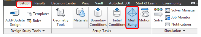

Click Mesh Sizing from the Setup tab:

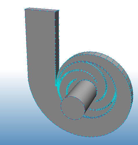

Apply Automatic mesh sizing in ONE of the following ways:
- Left click, and click Autosize from the context toolbar:
- Click Autosize on the Automatic Sizing context panel:
Note: The result should look like this:
