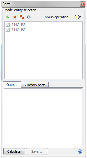

Click Parts from the Results tab:
Select the two houses.
Check the box adjacent to each part (in the Model entity selection area).

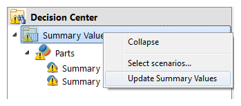

To start comparing results, click the Decision Center tab:
In the Decision Center, right click on Summary Values, and click Update summary values.

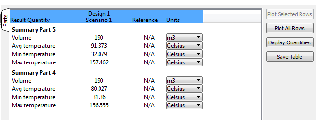

View the results table in the Critical Values tab of the Output bar.
Note: This procedure provides the results in a simple table. It is now easy to compare and plot the results between the two houses. Use this technique to compare results from multiple designs and scenarios.
