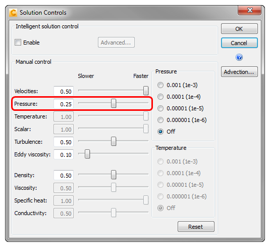

Click the Solution Control button, and move the Pressure slider to 0.25
Note: This improves the stability of the calculation. We recommend this step for flow-induced motion analyses.
Click OK, and then Solve to start the simulation.
