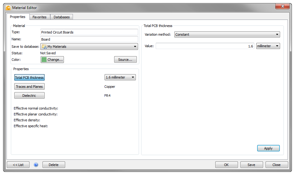

Change the Type to Printed Circuit Boards.
On the Material line, click Edit...
Enter the name Board in the Name field.
Select My Materials from the Save to database menu.
Click the Total PCB Thickness button.
Value = 1.6; Units = millimeter
Click Apply.

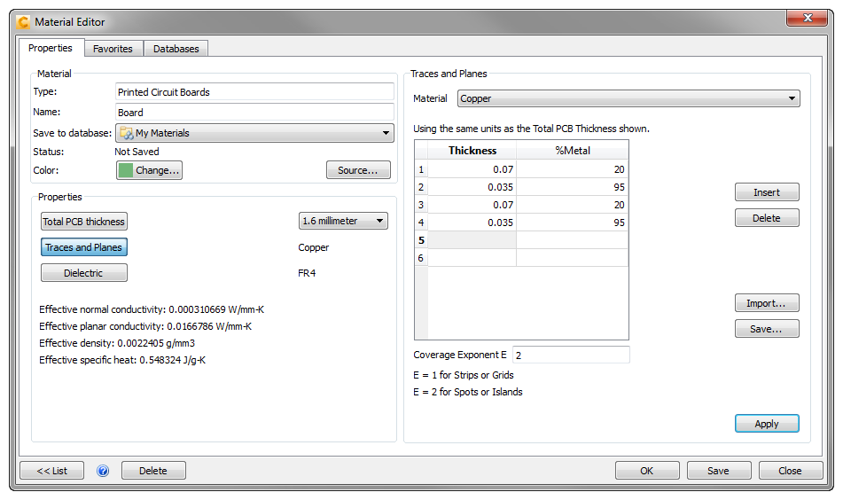

Click the Traces and Planes button
Material = Copper
Layer 1: Thickness = 0.07; %metal= 20
Layer 2: Thickness = 0.035; %metal = 95
Layer 3: Thickness = 0.07; %metal = 20
Layer 4: Thickness = 0.035; %metal = 95
Delete all data points on rows after Layer 4.
Coverage Exponent = 2
Click Apply.
