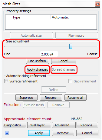

Coarsen the Mesh on the Capacitors
This step coarsens the mesh on the three capacitors. We do this because the default sizing is finer than needed. Making the mesh more coarse reduces the overall calculation time of the analysis.
Hide the case and the two air parts.
Select the three capacitors.
To modify the mesh sizing, do ONE of the following:
Move the Size Adjustment slider to 2.
Click Apply changes.
Click Spread Changes.
