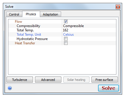

Click Solve from the Setup tab:
Click the Physics tab.
Flow = On
Compressiblity = Compressible
Total Temp. =162
Total Temp Unit = Celsius

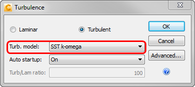

Click the Turbulence button. On the Turbulence dialog, set the Turb. model to SST k-omega, and click OK:

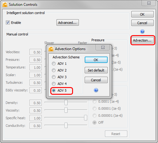

Click the Solution Control button. On the Solution Controls dialog, click Advection.... On the Advection Options dialog, select ADV 5. Close both dialogs.
