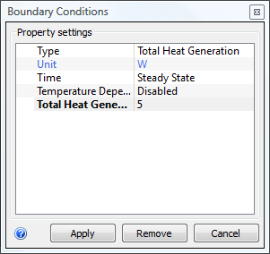

Click Boundary Conditions from the Setup tab:
Set the Selection Mode to Volume from the Setup tab.
If necessary, hide the casing and the air parts by middle-clicking on them.
Select the three chips.
Open the Boundary Conditions quick edit dialog in ONE of the following ways:
Type = Total Heat Generation
Units = W
Total Heat Generation = 5
Click Apply.
