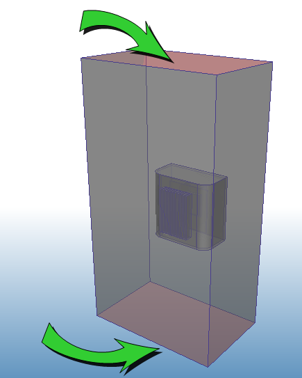

Assign Pressure Boundary Condition to Inlet and Outlet
Click Boundary Conditions from the Setup tab:
Select the openings at the top and bottom:
Open the Boundary Conditions quick edit dialog in ONE of the following ways:
Type = Pressure
Unit = Pa; Pressure = 0
Click Apply.
