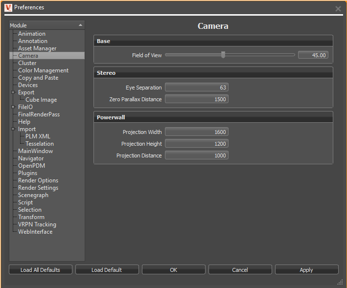

Use the VRED Preferences to customize your experience. Click an option listed under Module to load those preferences into the panel to the right. For information on a particular preference, see the other help preference topics.
  1. In the Menu Bar, click Edit > Preferences.
    Preferences
  2. Select the category you want to set preferences for on the left side of the dialog box.
  3. Make your changes.
